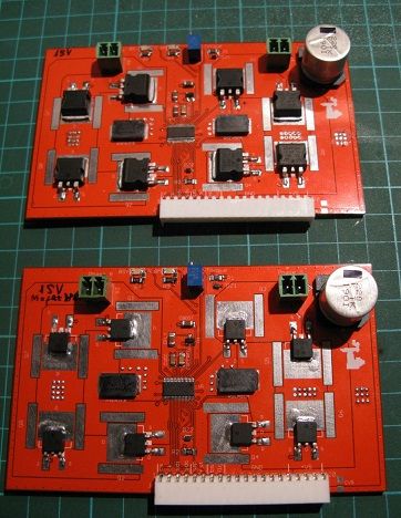

Afterwards, I have mounted two boards, for comparing their behaviors:
One board with
STD25NF10T4
Mosfets, Vg=15v, (DPAK), as EVAL6482H board.One board with
STB80NF10T4 Mosfets
, Vg=15v, (D2PAK, a bigger mosfet).is
successfully activated
, motor runs, and FLG is not activated). (Led yellow On, Led Red Off)2) Board withSTB80NF10T4 Mosfets
runs fine when there is not any motor connected. (BSY flagis
, and FLG is not activated, Led yellow On, Led Red Off). But when I connect a PaP motor and I send a Move command, FLG signal is activated. (Led yellow Off, Led Red On) Then GetStatus() returns thisError: 0x00000603
Overcurrent event is right away activated, but there is no reason for this happen. What is happening?

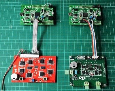

As is shown in this image, the
test
environment
is very simple: Two STM32F4 DISCOVERY boards, connected to this PCB boards. However, the resultsare totally different.
.. I ask to ST the same question once again: Is L6482H able to drive bigger Mosfets than STD25NF10T4 model?
Has this situation
ever
been tested
by ST? Maybe I should stop trying to control these MOSFET, and use these smaller STD25NF10T4 Mostfet....2014-06-24 3:56 AM
