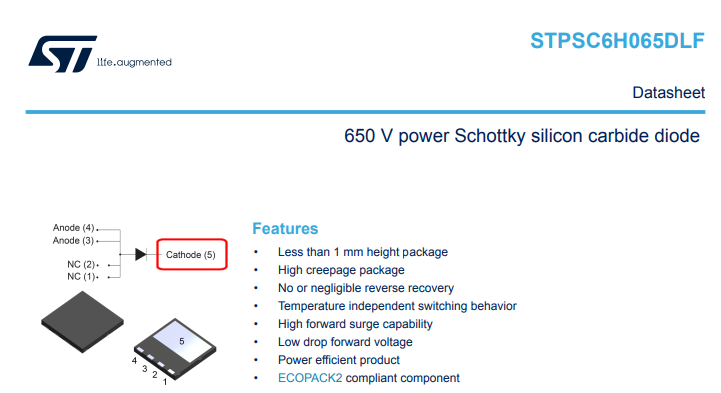

@mohamed_badran wrote:Is it applicable to connect exposed pad or cooling slug to Main pin as cathode ?
According to the datasheet, the exposed pad is the only connection to the cathode:
So, if you don't connect to that, you won't have any connection to the cathode at all !
