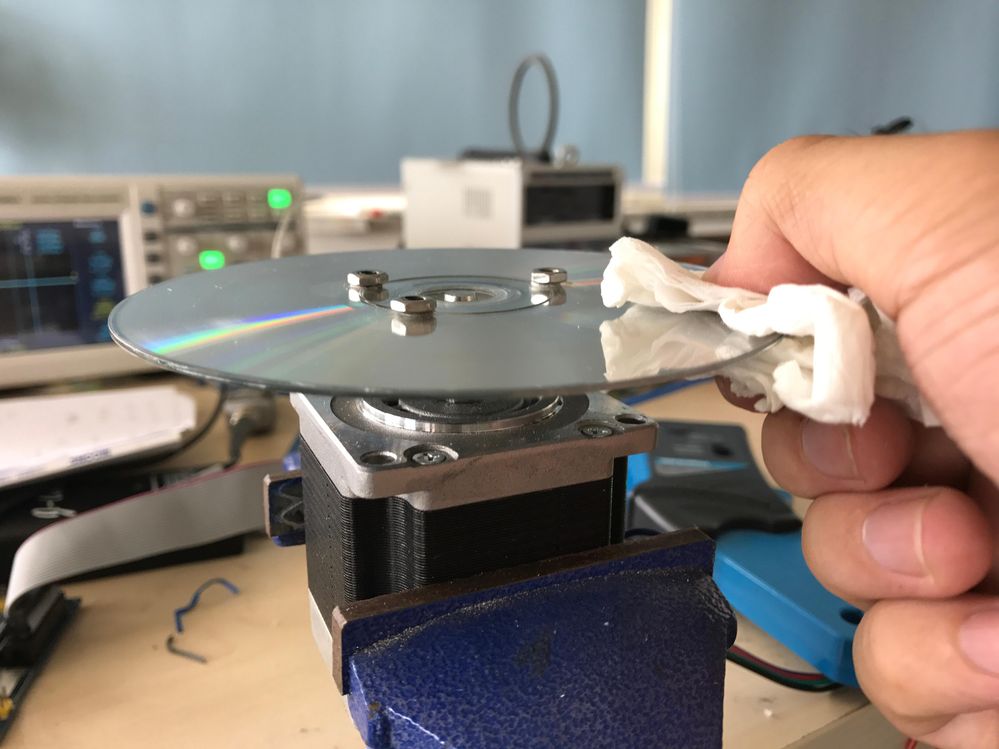

I solved question 1 with grip friction like follow gesture on an old disk.
So, another question is floated to the surface, is this mode couldn't run with light load scenario?

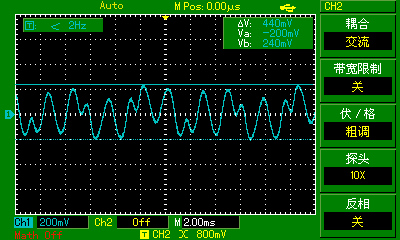

The Voltage mode have limitation of not able to control the field weakening ,as your rpm is increasing the Back emf is proportionally increasing and it constantly tries to reduce the current flowing in the stator .
Hence with voltage mode you cannot take the motor above the rated speed that may be around 1300 -1400 steps per second .
if you try to make motor run over rated voltage it will stall as Eb > V and Back emf will stop current flow.
Hence near the Peak Rated RPM zone your motor starts to shake as the back emf is reducing effect of your applied voltage and the system is not able to compensate as voltage has reached to rated voltage.
You are able to run in current mode because in this mode it can do
https://www.quora.com/What-is-field-weakening-in-motor
hence it can allow you to operate at RPM ranges greater than rated.Q3
The current must be more or less constant in voltage mode as well this indicated that you need to recalibrate the back emf compensation in the voltage mode .
Your system is Over Compensated.

If your initial tests were with a bare motor that is very unstable mechanically and will stall easily. You should add some inertia to the system. Connect to a drive shaft or whatever you intend to drive, or just a cylindrical mass. Stepper motors are a mechanically resonant system and will tend to go unstable and stall in a mid-range resonant band which is often around the speeds you are indicating.
You either need to blast through it before the resonance has time to build up or change the mechanics of the system to move where the resonant frequency lies.
Frictional damping can help but you are throwing away torque and it is pretty hard to get a decent current into to motor with these chips.

You can see the results of monitoring the sense resistor voltage under the two connection modes in my post here:
