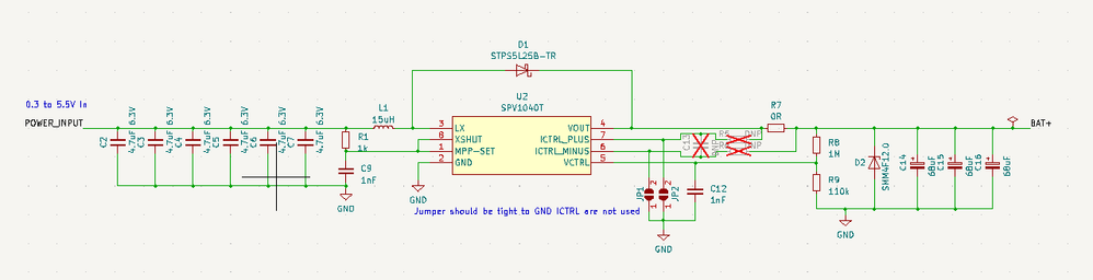

Hi ST communitiy,
Here is the schematics of my design using SPV1040T chip. I used the eDesign tools to generate this schematics. The jumpers JP1 and JP2 has been closed.
I just burned the chip while applying 2V 1.4A with a laboratory source. The battery is a 12V lithium battery with its own internal security circuit.
I thought the chip was supposed to self protect itself in case of over current or overheating.
Any clue of what could have append ?
