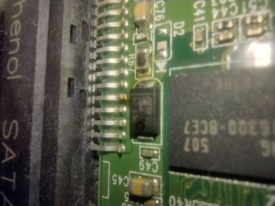

2024-11-09 12:19 AM
Hello I need to replace Gp450
please help me
2024-11-09 12:38 AM
Some chance you could take a picture that's in focus?
Does it say SUA ? That would be be part# not the date code.
2024-11-09 9:25 AM
"the marking is SUA, which corresponds to the SMA6F5.0A-TR, which can be found today with 6AI marking."
