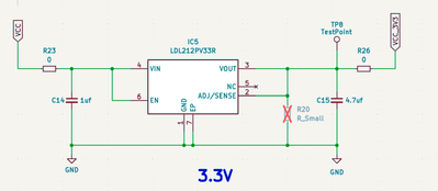

Hey @Peter BENSCH  , thanks for reply.
I just wanted to verify a couple of things .
1) Are my calculations correct ?
2) I dont know the thermal resistance of that area , its just a big chunk of copper area connected to the exposed pad intended to increase the surface area for heat dissipation. I thought i had overdesigned , but after looking at the temp i guess some major issues going on
3) Please enlighten me about any numbers i am missing out on
Also is 750mW too much heat ? I thought a DFN 2x2 package should be capable enough to handle it
I have added the schematic i am using as well just for your reference
  1. Well, the complete consideration of the effective temperature, especially in your calculation 3 (you called it Case Temperature (TCT_{C})), also includes the thermal resistance of the cooling area, which still needs to be added. Using a thermal camera, you can then look at the heat distribution on the board and probably recognise a hotspot directly at the LDL212, while the temperature quickly decreases as the distance increases.
  2. As already mentioned, it is advisable to calculate or simulate the thermal resistance of the cooling area. Regardless of this, you should use additional cooling area, e.g. on the other side of the board, and as many thermal vias as possible, especially in the close vicinity of the LDL212 to distribute the heat as widely as possible. You can also consider using a thicker copper layer, which makes the board more expensive but also improves the heat transfer to the cooling area (heat build-up around the LDL212).
  3. With 150mm² you seem to have a lot of cooling surface, but as you realise, this is obviously not enough. The amount of heat generated and its removal is often underestimated. To get an impression of the heating of a device, it is sufficient to load e.g. an ohmic resistor with e.g. 750mW and measure the resulting temperature (or hold it in your fingers). You will find that the temperature is inversely proportional to the component size, which is simply due to the thermal resistance of the device (and also the thermal resistance of the environment, e.g. the fingers). Yes, the DFN 2x2 package can handle this power dissipation - if you ensure appropriate cooling.
  4. Speaking of heat distribution: if you know the current consumption of your 3.3V load very well, you can possibly change R23 from 0ohms to a larger value. At 8.2ohms, for example, a voltage of 1.804V drops at 0.22A, i.e. a power loss of 397mW. The power dissipation that the LDL212 has to burn is then reduced by this value. Of course, you then have to use a resistor with a corresponding power capacity - and ensure that it is cooled. So the problem remains the same, it is just distributed.
Hope that helps?

@Peter BENSCH Thanks a lot for the prompt reply peter .
So here's what i understand
1) I am still yet to calculate or find out the thermal resistance of that PCB copper area , i know the thickness of the copper but i don't know the exact calculations for that . So I'll probably test that
2) With the given power dissipation and the package size , is it okay expect for the temps to go upward of 55 degrees with whatever cooling capacity is given ? Which i just mentioned. (55 degrees was measured on top of casing of the ic )
3) Even if the DFN-2x2 package is capable of handling such powers , i could not find any recommended landing pattern or PCB layout guideline for the LDO , can you point me to any such ST whitepaper or Application note ? So that i can keep a note of this in the future . I thought i am consuming just 220mA and the LDO can take up to 1.2 A , i should probably be good with some copper area as a heat dissipation area .
4) As of now if i don't have to fabricate a new PCB , i am already on my way of testing the series resistor to share the heat dissipation by dropping the input voltage . Would you recommend adding a heatsink on top of it ? Or what can be some other methods or suggestions you can give which do not involve a new design .
And would you consider this a design "mistake" or just an "oversight" because we didn't have tools for thermal simulations and all to figure this out earlier before fabrication.

Hey so the resistor Idea worked for me and the heat is much better distributed between the series resistor and the LDO . From the next time I'll try to improve the layout to use the LDO without the series resistor
