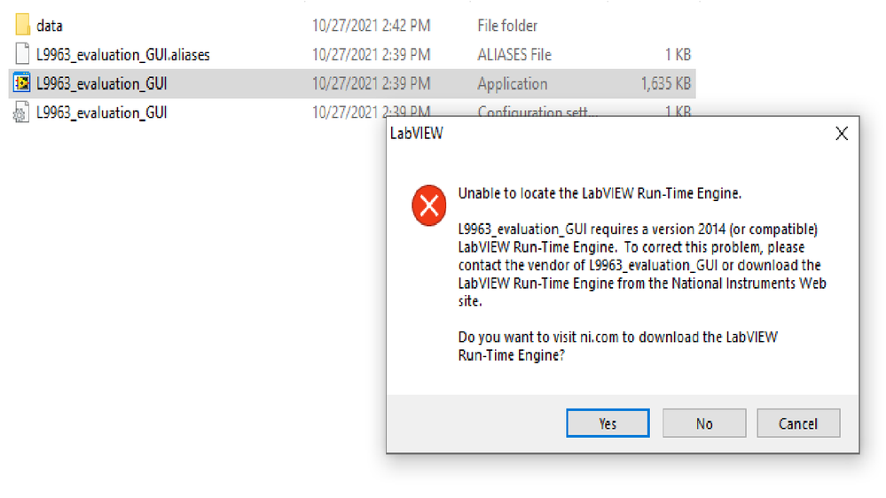

when i am installing the software a pop up is coming like "Unable to locate lab view run time engine"
i have tried the
1> NI Labview-runtime 2014
2>NI-VISA Run-Time 14
and followed all the instruction provided by STSW-L9963E datasheet. But we failed to install the softwareplease help me.
2023-07-29 8:47 AM
Same here, HELP!
2023-07-29 8:59 AM
Found it: it needs the 2014 32-bit runtime!
One could have wished for a complete installer application.
