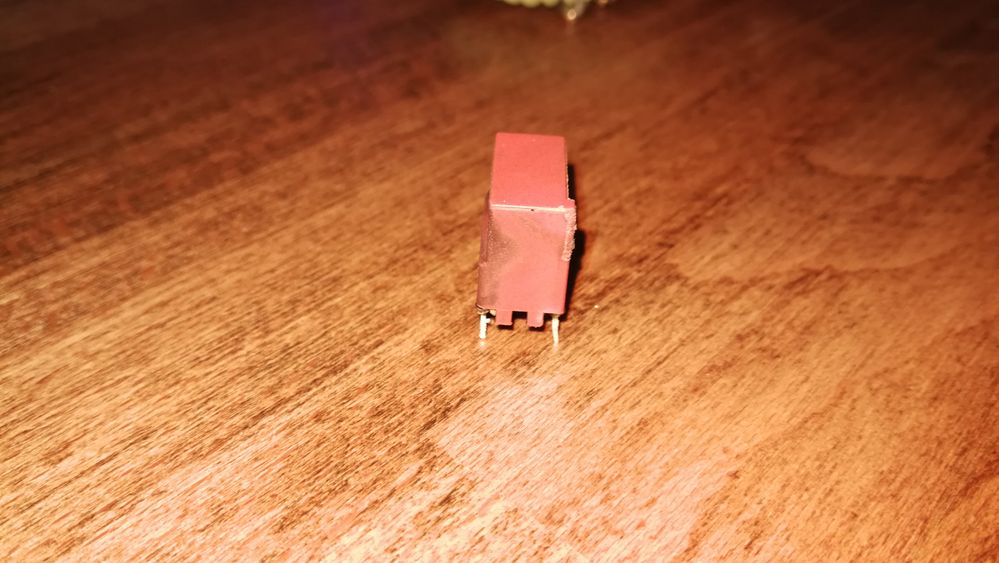

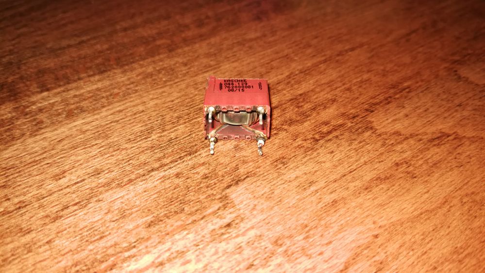

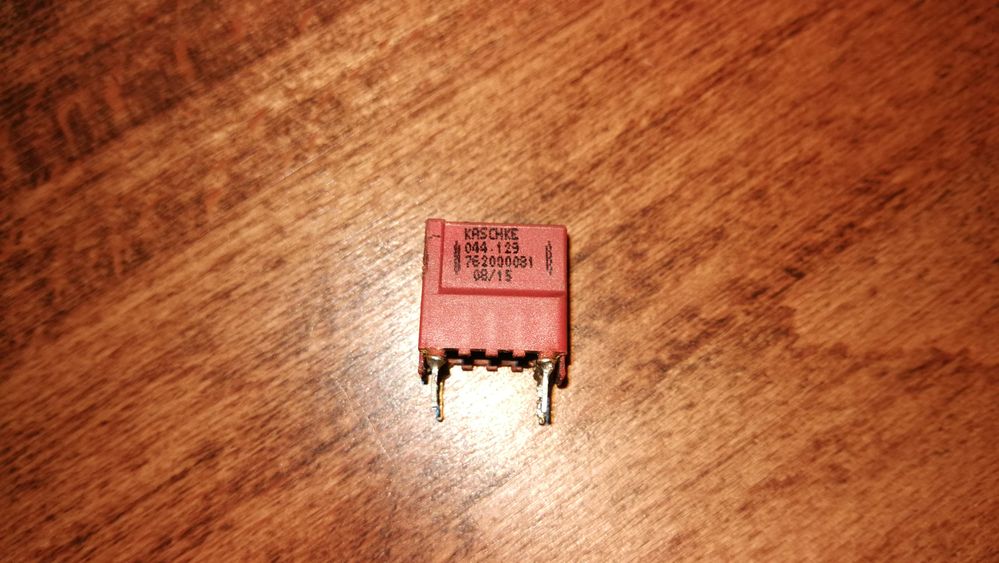

I don't have some of the info with me that you've requested, but I have a few pictures that are hopefully helpful to you.
I believe it is some type of inductor - it has 4 pins. I'm not sure what exactly it's purpose is in the circuit.

Common Mode Toroid Choke, perhaps custom, you'd likely need to measure one not blown up.
The off-the shelf ones have details, typically current/voltage
Similar
https://www.yoycart.com/Product/546971818050/
https://www.kaschke.de/enquiries/
https://www.solutions2business.com/wp-content/uploads/2017/06/Stromkomp.Ringdr._Flyer..pdf
RDS 1517 TOROID CHOKE
The Kormag guys might be more helpful
https://www.kormag.co.uk/filters.html
https://www.kormag.co.uk/products/pdf/FL_Stromkomp_RDS-KV3.pdf
