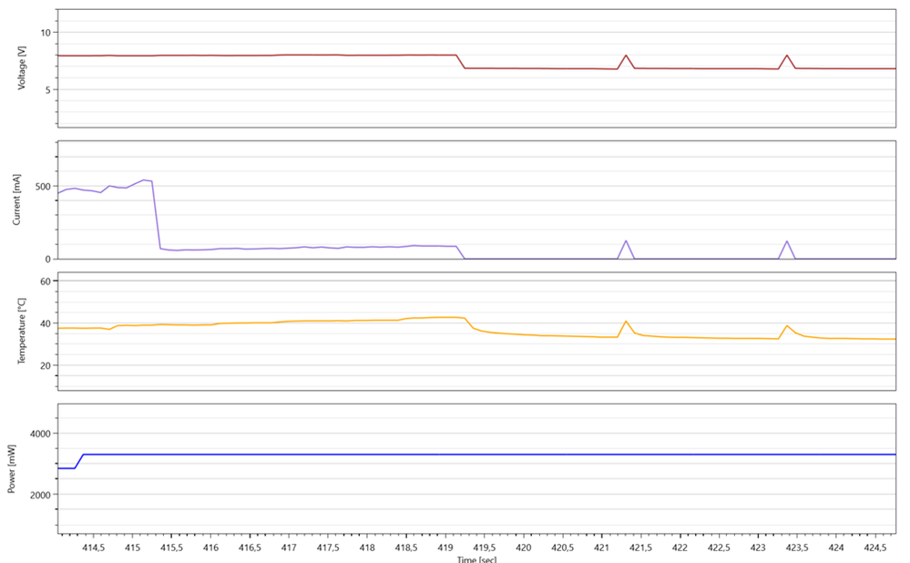

FIG 1
FIG 1 depicts the operation of the STEVAL-WBC86TX: after a certain runtime (approximately 419 s), as indicated by the "Voltage" graph, the system transitions from 8V to 7V when the receiver is removed and returns to the PING phase.

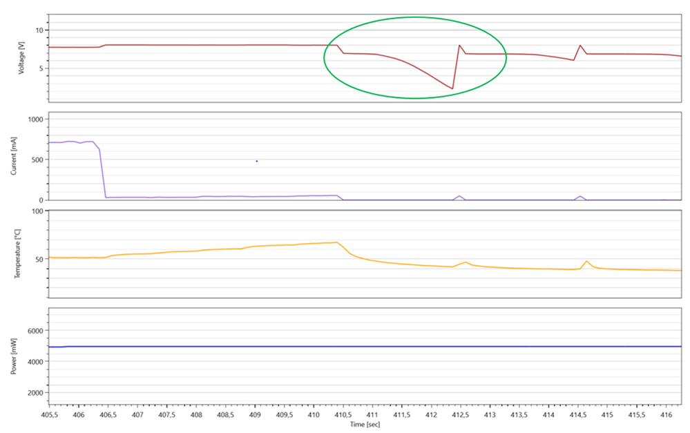

Now, considering the following graph referring to my PCB (WBC86TX):
FIG 2
FIG 2: Initially, the board was functioning correctly as it transitioned from the transmission phase to the Ping phase. However, after a certain period (approximately 410s), the Voltage dropped significantly before returning to the Ping phase. After bringing the receiver close again, the system became stuck, as described earlier.

1.Does STEVAL-WBC86TX and your WBC86TX board have any hardware different?
2.From you picture 2, TX input voltage drop from 8V to very low, TX chip have reset, also chip temp is higher than STEVAL-WBC86TX.Seems your TX have some damage.
4.What is input power limited current?
5.What is the volume of application? How about contract local FAE to check and gain more information.

What is RX power, rx ouput and current? If you remove RX does RX absorb some power?
From your picture2, when you remove RX, TX chip temp rise from 50C to 70C. Seem TX chip consume many power inside, It is different with picture1.
How about you increase input limited current, Or set WBC86TX input voltage lower.
