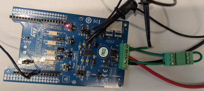

I've tested the IPS2050H short circuit protection with the STEVAL-IFP043V1 board and unfortunately it didn't go well.
Test setup according to below picture. IPD1 is connected to IN1 via 220 kohm resistor. Board powered with a 24V/15A PSU. The short circuit is introduced by inserting a connector with shortcircuited terminals. This resulted in a bang, a flash and a hole in the IC.

Hi Fredda,
thanks for sharing your experience. It looks crazy, let's try to fix the issue ;).
We have realized, the J3 jumper on your STEVAL is left open. This means the Transil Diode at the supply terminal is not involved. There are pulses with very di/dt during the short circuit, which may create an excessive overvoltage spikes on the supply bus due to parasitic wiring inductances etc. These overvoltage spikes may exceed the absolute ratings of the IPS2050HQ-32 and it may get destroyed.
Would you please try to insert J3? In that case, the overvoltage on the supply rail will be limited and the IPS2050HQ-32 properly protected.
I am looking forward to hearing from you any updates.

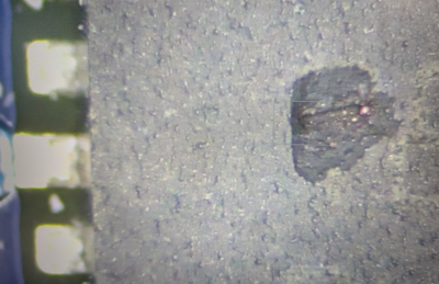

Fredda
Associate II
By the way, it seems like a bond wire to pin 6 (GND) has vaporized and exploded. Judging by the exposed straight channel in the crater.

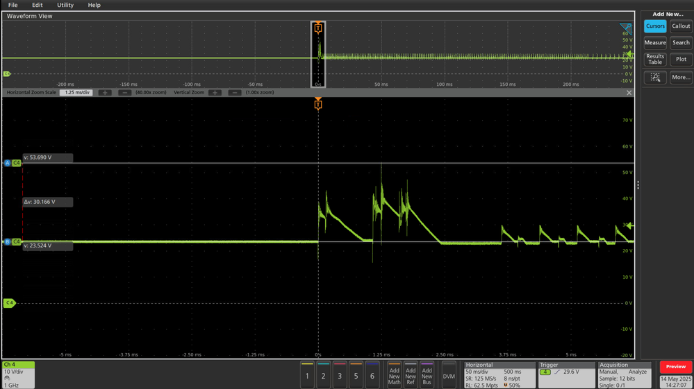

I've finally had the chance to short circuit the Power Switch with the TVS connected. It seems like the TVS is doing its job and protecting the switch from an excessive overvoltage. Great!
Short circuitShort circuit
/F
