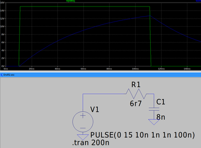

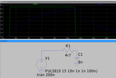

Lets try simu at the gate : 4r7 at 8nF ->
The 6v level, mosfet begins to switch on, is at about 20ns ; so there cannot be much internal gate resistance .
lets try ...adding 2 ohm:
Now current rise will be after about 30ns , good match with the 33ns from ds;
so internal resistance at gate might be something around 1...2 ohms.
