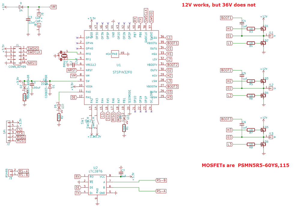

Max, did you by any chance resolve your problem? I'm having similar problem: my custom board works fine with 12V supply, works fine with 36V supply when motor is disconnected, but STSPIN32 chip dies immediately with 36V when motor is connected. Any ideas?

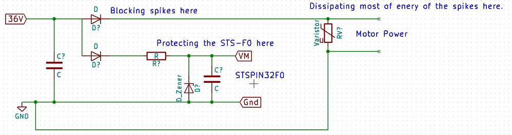

Question: OK, I can use overvoltage limiting IC like this one:
this will protect me from overfoltage on the power rail. What if it comes from the motor windings itself? What can I do about that?
Thank you very much, I hope you respond

I attached the schematic.My main confusion is where the overvoltage spikes might occur: on the power rail or on the motor windings. Power supply spikes I can take care of. Motor spikes I have no idea.

STSPIN32F0 has 3-phase driver integrated. This is why it can drive MOSFETS directly. It also has 3.3V buck converter integrated. That is the beauty of it! So I don't have any other schematics to show you except what you see in the picture above. If I did not understand you correctly please explain.

Which Fets are you using ?
I mentioned them in the screenshot. These ones:
https://assets.nexperia.com/documents/data-sheet/PSMN5R5-60YS.pdf
can you see the G-S breakdown voltage, this is usually where the smoke starts.from.
Vgs MAX = 20V.
HOWEVER! This is
STSPIN32F0 that dies, not mosfets. I can tell because it does not generate 3.3V any more. If I turn the board on without motor I can see the led. If I do it with motors, it dies. Does it light up for a second? - I'm not sure.
