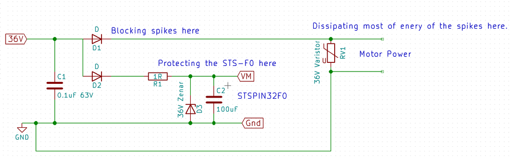

page 9, VM 45V maximum before it blows up...
since the drive fets are off chip,
the VM trace can be adjusted slightly between the STspin32F0 Pin VM and the MotorFets VM. <- spikes from here
here I have added spike suppression and 100uF capacity to the STspin VM pin.

Thanks for your reply, I'll try it out using the devboard.
2018-04-02 5:19 PM
did it work ?
2018-04-02 10:33 PM
Yes, it did.
