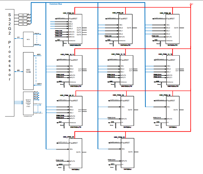

Hi, In one of our new application, we are using different ST make high-side power switches, to switch different loads at 12V DC (Battery Input Voltage Range : 9V to 16V DC), here is the details
Is this architecture work switching of loads through high-side drives?
Also suggest me any improvements on circuit application if any.
I believe you missed to include the important part, How are you connecting the VN70....'s to your loads?
