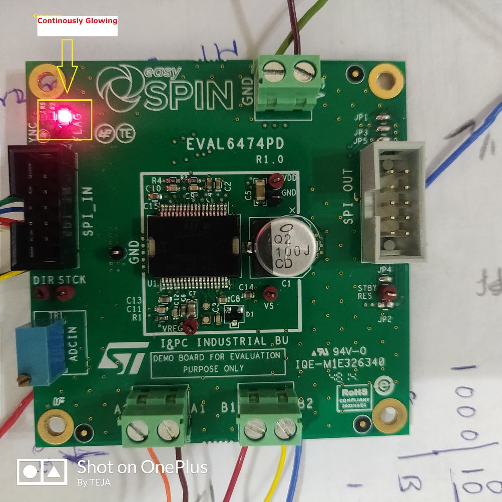

Hi @Cristiana SCARAMEL
We attached a PIC of drive error which is getting please find it below.
As You mentioned we checked the above three points are coming correctly.
We are able to rotate the motor with drive but we are getting that error continuously.
We have enabled only four errors in Alarm_EN register.
