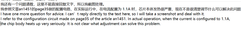

I edited the title translating it from Chinese to English with Google translate for an easy research in the Community

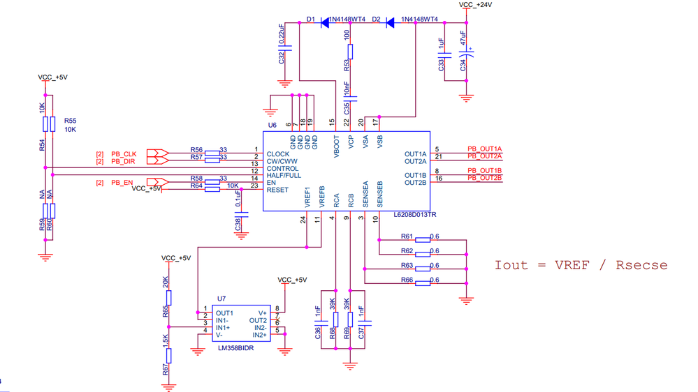

Hi @Wyoun.1,
the circuit at page 35 of application notes AN1451 is related to a package option no more available.
Are you using the L6208PD (PowerSO36) or L6208D (SO-24) option?
Could you share your schematic with components value for a fast review?
Moreover, please give more details on the driving option: step mode (HALF/FULL pin status), decay mode (CONTROL pin status), voltage reference value.

I am using L6208D (SO-24)

Hi @Wyoun.1 ,
ok for L6208D.
What about the others questions?
Please provide more application details.

Step mode : HALF , Slow decay mode

Hello @Wyoun.1 ,
some feedback on your schematic:
To check the point 3 and if the RC values fitting the application requirements, could you share some oscilloscope waveforms with phases current and phases voltage of the motor?
The not proper working of PWM current control could cause extra heating.
