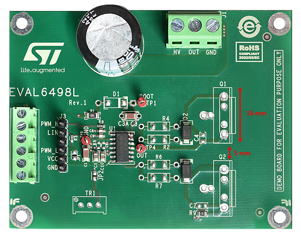

I am planning to use EVAL6498L to build a boost dc-dc converter with synchronous rectification.
I notice that if I fit two TO-220 switches these will be very close, therefore I am not sure what heat-sink I can use, as mechanical space becomes a problem if I use this heatsink (RA-T2X-51E), which I was planning to use.
Would you have some recommended type of heatsinks that can be used for TO-220 switches sitting on this EVAL6498L board?

Hello @Lello,
I cannot suggest a specific brand or part number for heatsink.
In any case, the model you linked is too wide (about 42 mm).
Considering the transistors placing in the EVAL6498L, I suggest you use a heatsink maximum width of 18 mm.
An alternative solution, could be to use a single heatsink for both transistors by adding a conductive insulator (paste, thin film or pad).
