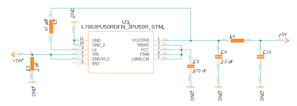

2022-05-04 8:53 AM
Hello Peter,
so the result is the circuit diagramm in the picture. Could you please have a look at it?
I want to use the 1000 kHz, therefore i connectet FSW to VCC. And because i want to use the LNM i connected it also to VCC.
Do i have to calculate the whole PI-filter, or just the L4 because C4 = 2.2µF (from the datasheet) and C16 has to be equal?
VOUT will be +5 V and will be connected to the other parts like the INA and the microcontroller.
Do i have to add another capacitor to filter the input voltage?

2022-05-05 12:30 AM
The output voltage at pin 1 (VOUT) can supply the microcontroller, while the +5V at C16 is fed to your analog measurement circuit.
C4/L4/C16 form the Pi filter. The values of L4 and C16 result from the desired attenuation: for a cut-off frequency of e.g. 100Hz you will need about 100mH and 22µF.
Please choose the saturation current of the inductors L4 and L2 larger than their peak current, because otherwise the inductance collapses and the function of regulator and the filter is no longer guaranteed. C16 should either be a ceramic MLCC only, or a parallel connection of e.g. 22µF tantalum and 0.47..10µF MLCC.
