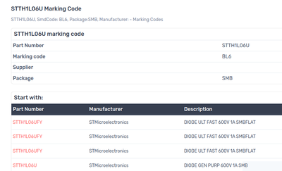

I have a board with an ST component in SMB housing (a diode?) marked BL6, next line GP 733. What part number could this be?
2024-06-17 10:48 AM
maybe:
2024-06-17 10:48 AM
maybe:
2024-06-17 11:16 AM
The "GP 733" is a production plant and date code.
