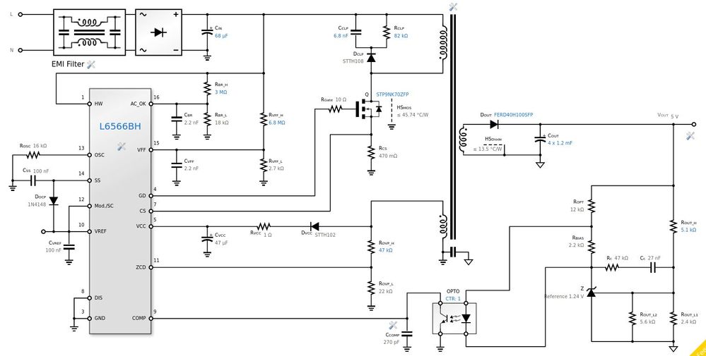

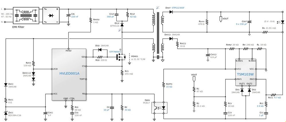

The following two designs were generated by EDS:
Could someone please advise which one is more recommended for powering a LED strip? And can you suggest any off-the-shelf transformer PN that can go with any of these designs?
