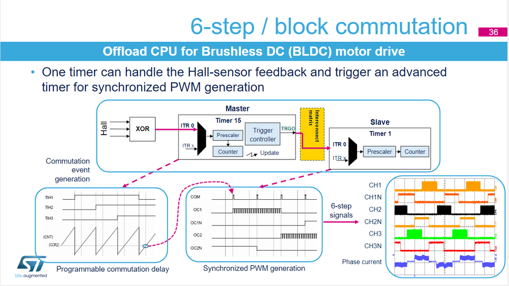

How to work on STM32 inbuilt 6 step drive with hall sensor interface.
Does anybody know any datasheet or reference manual for this?

I'm working on sensorless BLDC motor with Six Step control.
The application using the hall sensor seems to be as follows.
I think these application note and web site help you.
