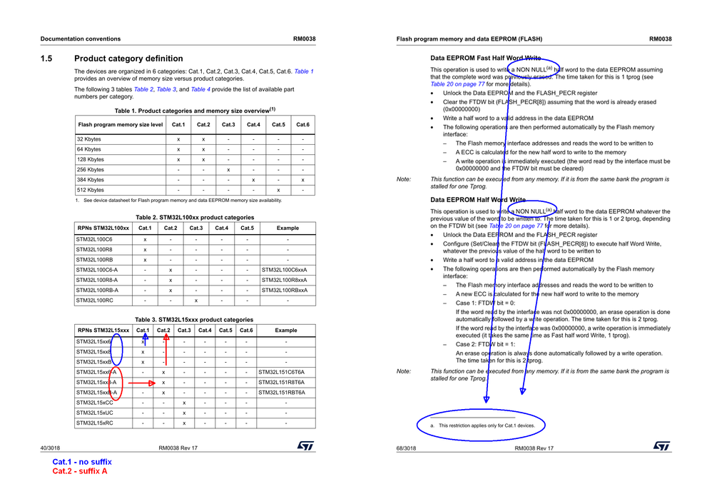

Hi @Community member ,
Thank you for bringing this issue to our attention.
For Cat.1 (no suffix) devices, the Byte write can be used only to write a NON NULL byte.
In contrast to Cat.1 devices, in Cat.2 (suffix A) devices the Byte write can be used to write a NULL byte.
This difference between the two categories will be added in the new TN1176 update.

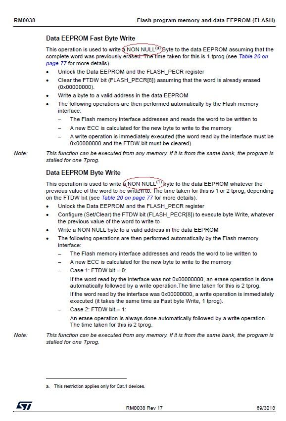

This is the page of the RM I’m talking about:
The device I’m using is a CAT.1 (STM32L151C6T6 or STM32L152C6T6)

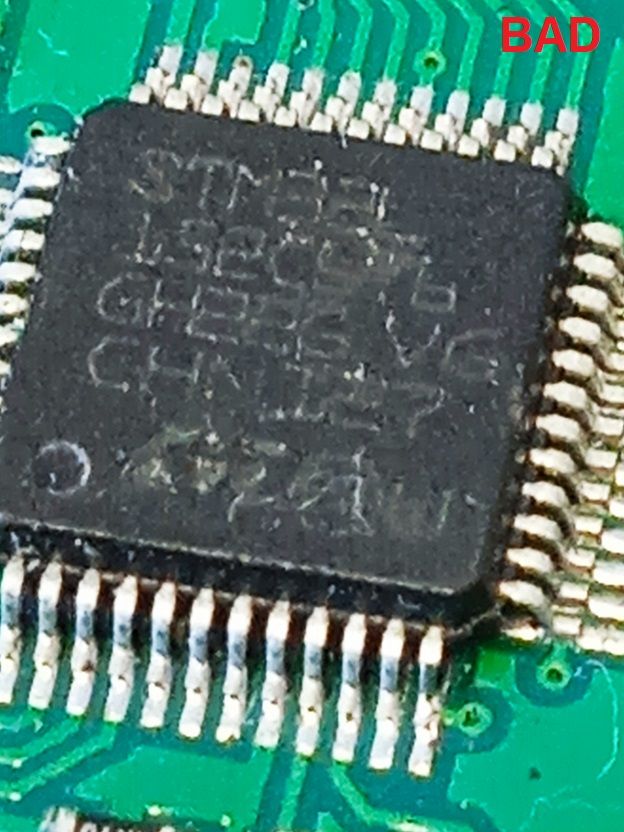

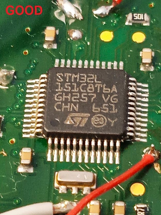

Post photos of "good" and "bad" chips.
2022-07-28 2:27 AM
Indeed it seems that the "A" parts don't suffer of this problem. But it is not documented in the manual... Can we trust that "A" parts don't show this problem?
Thanks
It is:@Amel NASRI ,
can this difference between the non-suffixed and -A 'L151x6/8 please be documented in TN1176 ?
