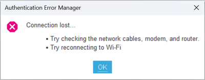

This is the first time I use STM32cubeIDE ver 1.15.1 . While using it, there are a few operations that need to be logged in. I already have an account in the practice room at school, but when I log in on my personal laptop, I see a box. "Authentication error manage" dialog as shown below
meanwhile my internet connection is completely normal.

I think a lot of people are having this problem today. Come on ST get it fixed. We are trying to do some work here.

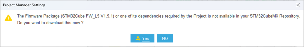

Same issue With STM32CubeMX V6.11.1
I click yes, and then:
The suggested solution of changing proxy settings doesn't work for me.
