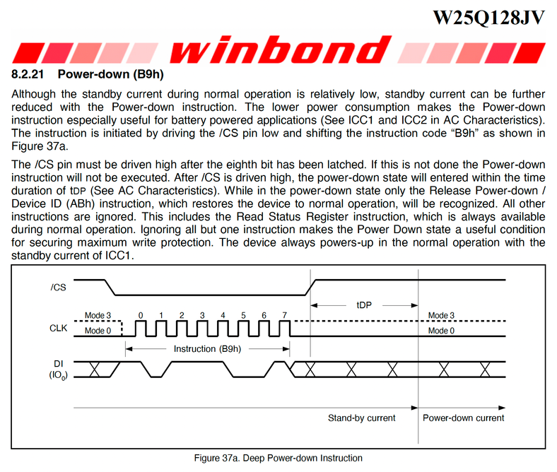

I can read and write data but the W25Q does not seem to respond to the power down command.

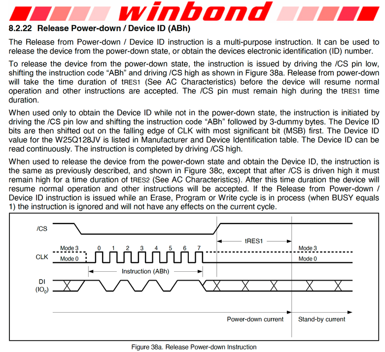

When I send the power down command 0xB9, reading data from the W25Q should not be possible until the release command 0xAB is sent.
However, I am not sending this release command but can read data from the W25Q, which indicates it did not enter power down.

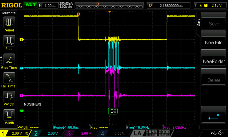

Below is a scope capture of the power down command and it looks correct...

My mistake.... the power down was working afterall
I did not realise I was sending the release command, if I remove the release command then the W25Q read fails
