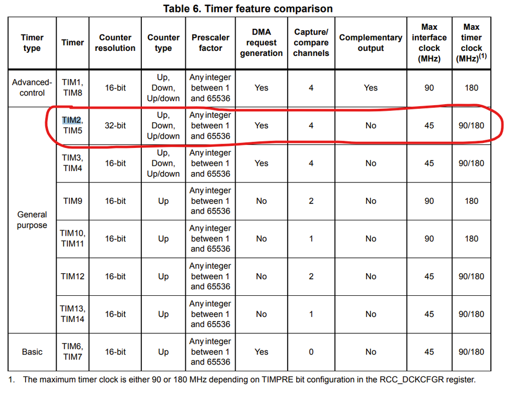

2022-11-16 11:24 PM
Hello @Danish
Thank you for your response. Before using the timer 2, I did check the manual about timer in the datasheet as below:
And timer 2 has a counter of 32-bit.
That is why I got confused a bit.
