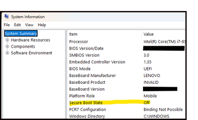

On the new PC, is secure boot enabled?

I did a try also with secure boot disabled and with USB 2.0 hub but nothing change.
