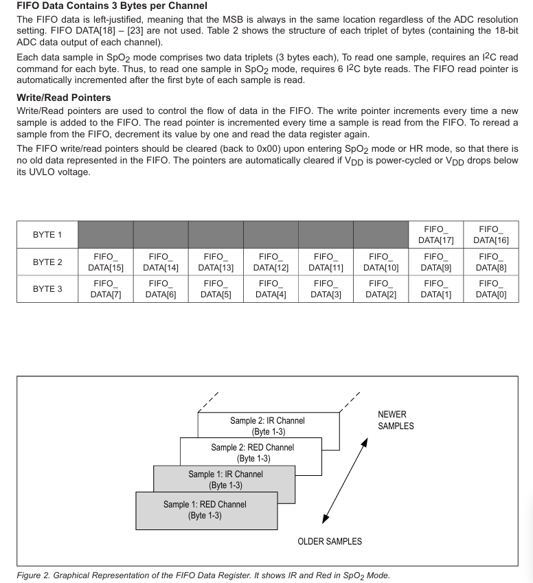

When reading the FIFO buffer through I2C read command, we typically retrieve 6 bytes of data: 3 bytes for the Red LED value and 3 bytes for the IR LED value.
The question is: how is the data arranged in the 6-byte buffer?
Is it organized such that bytes 0 to 2 represent the Red LED data, and bytes 3 to 5 represent the IR LED data?
I also noticed that some MAX30102 firmware driver using bytes 0 to 2 represent the raw IR LED data, 3 to 5 represent LED raw data and vice versa.
I'm a bit confused about how the data is arranged when reading multiple bytes. Could you clarify the orientation of the data in the buffer?

2024-12-13 12:52 AM
Ok. To understand the behavior of I2C when reading multiple byte, is the first byte received is stored in buf[0], the second byte in buf[1], and the third byte in buf[2]?
2024-12-13 2:02 AM
Yes.
