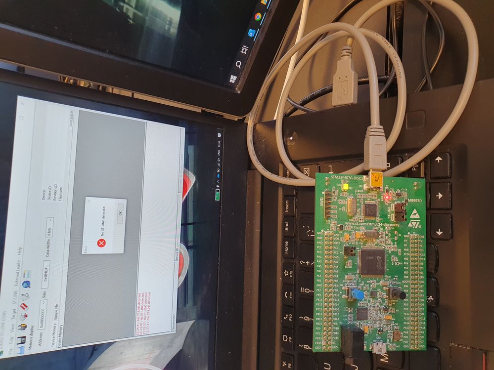

I'm unable to connect to STM32F407-DISC1. STM32 ST-LINK Utility gives "No ST-LINK detected" and STM32CubeProgrammer gives "Error: No debug probe detected". I run Windows 10 Business on a Lenovo ThinkPad P1 Gen 3 computer and I have tried with 2 different STM32F407-DISC1 boards, 2 different USB-cables and with both STM32 ST-LINK Utility versions 4.1.0 and 4.6.0. When I plug in my board, an additional "USB Composite Device" shows up under "Universal Serial Bus Controllers" in the Device Manager, but it won't let me manually update the driver to the one inside the en.stsw-link009-folder. I have tried to uninstall STM32 ST-LINK Utility, reboot my computer and install STM32 ST-LINK Utility again, but to no avail. Can someone please help me?

But isn't this a driver issue? Should the dev board really show up as a "USB Composite Device"? And should it really use the driver C:\Windows\system32\DRIVERS\usbccgp.sys, provided by Microsoft and have driver date of 21/06/2006?
