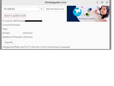

But the STLinkUpgrade.jar reported Unexpected flash size after opening the cable in update mode.
What can I do to use the cable?

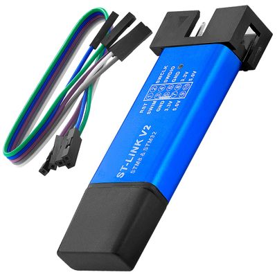

@Andreas_Engineer wrote:this ST-Link V2
What "ST-Link V2"? Did you mean to add a photo or link?
Beware that any so-called "ST-Link V2" looking like this:
is not a genuine ST product - so you get what you pay for!

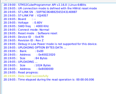

2024-03-18 1:23 PM

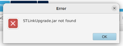

Please see below.
I tried to upgrade the firmware using CubeProgrammer too. Unfortunately it reports STLinkUpgrade.jar not found.
2024-03-18 3:48 PM
1. voltage 0,6V -> VDD is not connected to st-link (refuses to work usually), connect this vdd .
2. Data read success. -- no error here.
3. What shows CubeProgrammer if you just connect to your target cpu ?
2024-03-19 1:56 AM
1. Why does it require the target VDD to be connected to update st-link firmware? Isn't it powered by the USB host bus? The target does not expose VDD. We only use SWDIO,SWDCLK and GND.
3. The log above is when I click connect. It shows no error. So I guess, I will be able to flash the target images. But not be able to debug from CubeIde without updating st-link firmware.
I am guessing the flash size check of st-link was added recently? Can you please let me know the last version of the IDE which does not have this check? I guess I will have to revert to that version till this is fixed.
