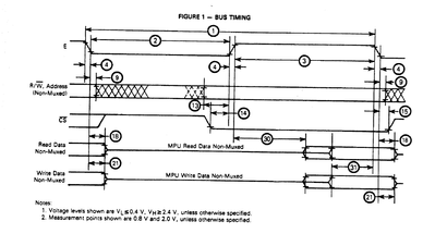

I can't see something related to E (Enable pin ) except this timing in the MC6821 datasheet:
So pulse width low and high are specified as minimum. I think no need to use a timer for that use a simple GPIO + delay and ensure you respect this timing.
To me the first post of @gbm is giving the right steps.

Not sure if it's something that could fit the chip requirement timings:
E, CS, RW signals needs to follow this diagram:
So I don't think using MCO + handling the GPIOs (set/reset) will fit this timing!
E determines a cycle of read/write here.
