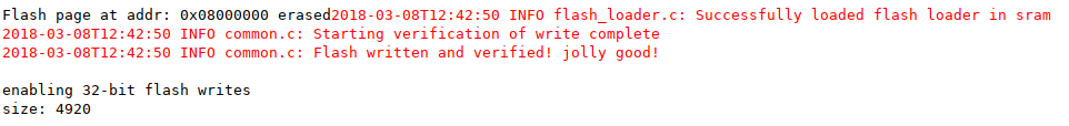

My system might be funky
I'm on Arch and I've tried both texane version (installed through AUR) and community repository version through pacman. They both giving kinda strange output. At first sight one can be scared, however nothing bad is really written there. Its just red
Do you have similar behavior?

No, no problems in displaying colored text on a terminal...
Try to install colorgcc and rxvt-unicode-256color and see if it makes any difference...

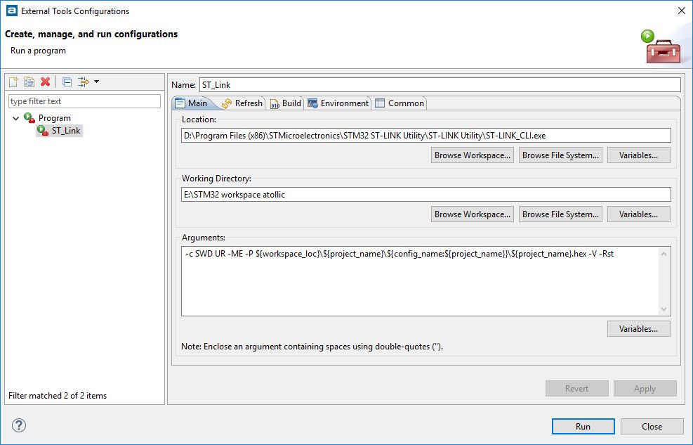

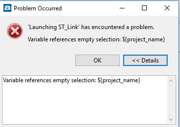

Hello, I tried to set up this configuration in my TrueStudio, but there is always an error.
My configuration is :
Can you help me solve it? Thank you.
2018-04-26 6:43 AM
I have noticed that your working directory is not like mine. I'm not sure if it can be an error or not.
Otherwise, I've issues if I do not explicitely select the project in the project explorer before launching the external tool. Check that the project you want to flash is selected before trying to run the external tool.
