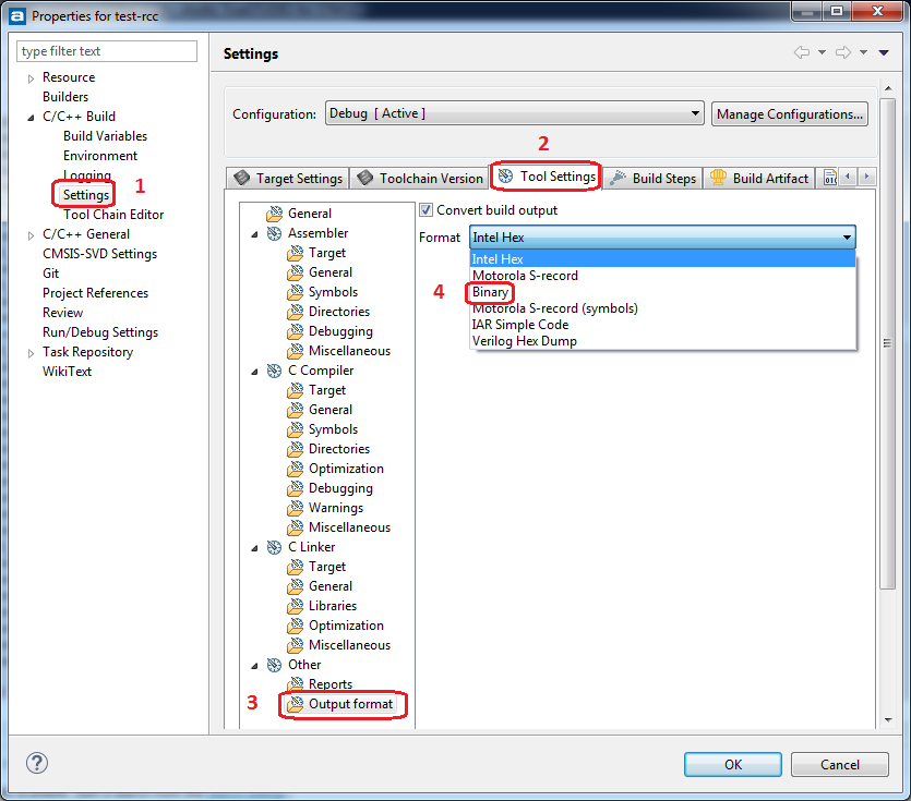

How to generate a .bin file in atollic?
#.bin #atollic2018-02-20 12:43 AM
From main menu please select Project -> Build Settings. Then please follow steps shown below.

thank you for the answer.
I did it. but this feature does not produce .bin.
It generates .binary and this file does not open in Stm32 Utility.
