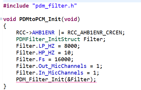

I have added libPDMFilter_GCC.a and pdm_filter.h,but truestudio told me that undefined reference to `PDM_Filter_Init'.I dont know why.Thank you.

Could you please confirm which library version used?
Maybe you should review the configuration of your project and make sure that your project contains all the required library source files.
