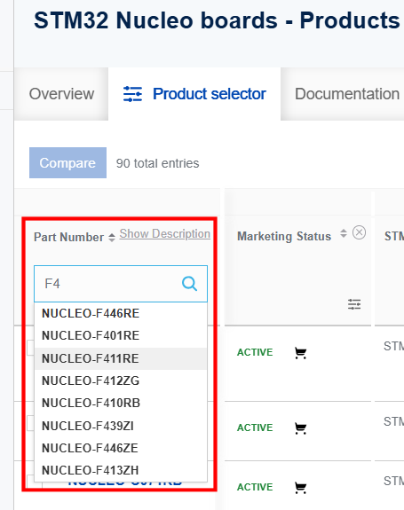

Alternatively, go to the Nucleo Boards product selector:
https://www.st.com/en/evaluation-tools/stm32-nucleo-boards/products.html
You can search by the microcontroller used; eg,
See which one most closely matches the feature set that you'll actually be using ...
