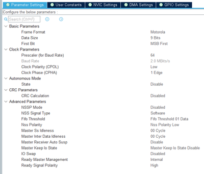

and I have configured it in CubeMX as follows (Note CS and RESET are configured as GPIO outputs).

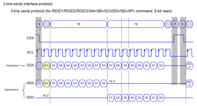

The timing diagram in the ST7701S datasheet looks like this :
This display is using Interface 1 as I understand it.  So I should be able to do a 9-bit transmit and then read the response.  I cannot get this to work with this simple code:
