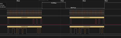

I am trying to send WHOAMI twice and when I look at the second frame my CRC almost always fails. If anyone can highlight why my CRC fails.
Attaching screenshot of my logic analyzer. CS, SCK, MOSI , MISO respectively.
Thank you

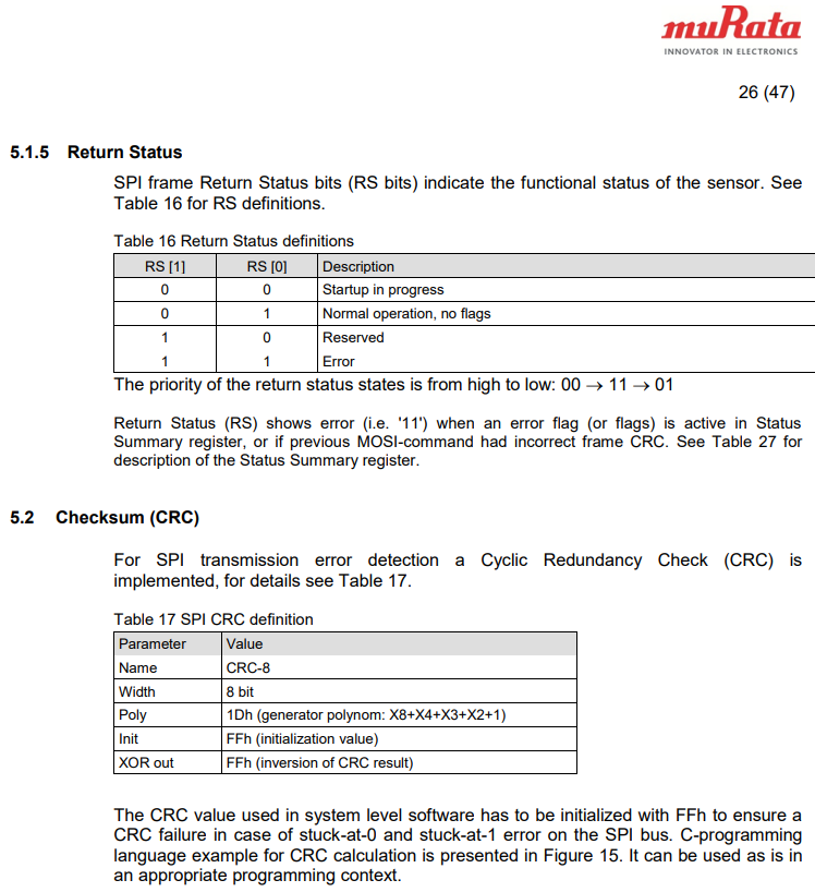

@sundar_ wrote:my CRC almost always fails.
Are you sure you are using the correct CRC (with correct initialisation), as described in the Murata datasheet?
via: https://www.murata.com/en-eu/products/sensor/inclinometer/overview/lineup/scl3300
Have you tried using the C implementation which they provide?
2025-10-07 11:18 AM
