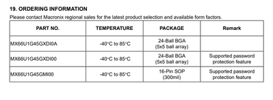

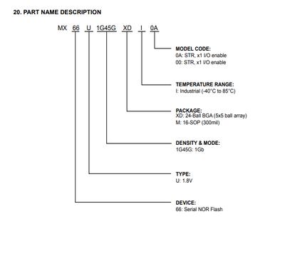

Hello @Dirty_Burner ,
Based on the MX66UW1G45G datasheet and MX66UW1G45G BSP component driver , the flash memory IC on STM32U5G9-DK2 board (MX66LM1G45GXDI00) belongs to the same family and shares the same core specifications. Therefore, the BSP driver for MX66UW1G45G is fully compatible and can be used with the MX66LM1G45GXDI00 without any issues.
For more information, you can check the Ordering Information section in the datasheet, which provides detailed component specifications and variants. Please see the screenshots below for reference.
