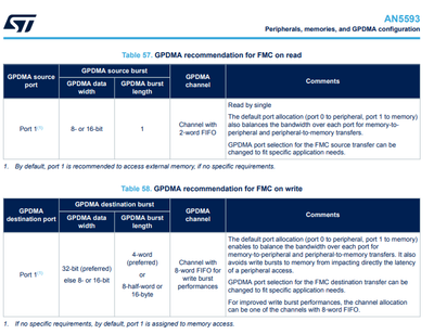

Hello @Vaishak-hoomanely ;
First of all I apologize for my late reply.
Ensure that you have respected the GPDMA recommendations for FMC shared in AN5593 "How to use the GPDMA for STM32 MCUs".
Thank you.
