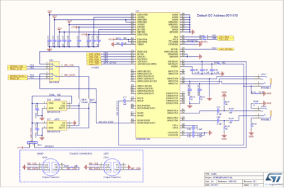

Normally you can use WM8994 as audio codec for STM32U5, it was already used in some ST Eval boards like STM32F769-EVAL using SAI interface:
(From STM32F769-EVAL schematics/MB1219). STL32U585AII6Q has tow SAI instances SAI1 and SAI2.
WM8994 driver is available here.

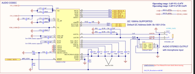

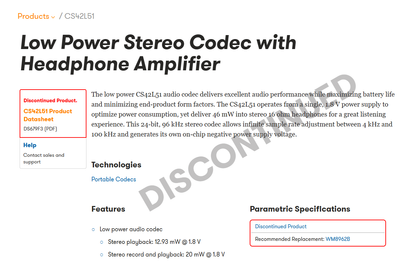

2025-12-25 3:20 AM - edited 2025-12-25 3:29 AM
You can isnpire from STM32U575i evaluation board
It uses CS42L51 audio codec.
Edit: it seems CS42L51 is obsolete from Cirrus Logic website.
It suggests a part number replacement: WM8962B
Hope that helps
2025-12-25 5:14 AM
Hi
Thankyou
Can WM8994ECS/R audio codec be used with stm32U585aii6Q
Thanks
Regards
Sakshi
2025-12-25 6:09 AM - edited 2025-12-26 1:24 AM
