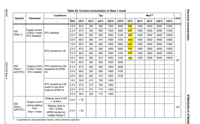

The current consumption in STOP1 mode is described in the table below:
