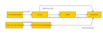

I have a setup on a PCB that resembles the following.
The 5V supply is pretty stable (0.5V tolerance) and the 3.3V LDO delivers a low-noise power to the microcontroller. The µC communicates with the outside world through CAN (transceiver present). There are already some precautionary measures present on this setup, as follows.
During routine operation, the communication with a sensor system (STM32F303CB on-board) was lost. On further investigation, the following was found.

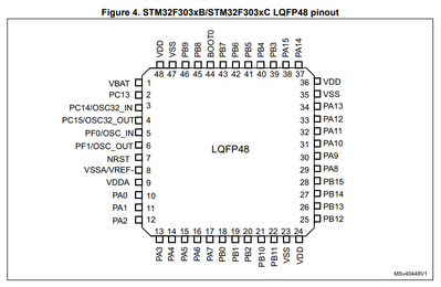

Figure 1 - STM32F303CB pinout
I looked into possible sources and found that through any ESD events directly on uC pin (not through the input connector which is already ESD protected) or any over-voltage event outside the specs can cause the protection diodes within any GPIO to break and make a short circuit. But through several inspection (optical and electrical), I could find no evidence of such an event.
Any ideas on why such a short might occur? If so, is there any other way in which I can find the cause for it?

My guess is that power sequence was not respected. According to note 1 p. 58/149 DS9118 Rev 14:
VDDA must power on before or at the same time as VDD in the power up sequence.
VDDA must be greater than or equal to VDD.
Since VDD & VDDA divided over PI-Filter (What is that ?, and what P/N of LDO?) you have to ensure VDDA never falls before VDD. It could be as easy as installing one schottky diode or special power management IC.

The Pi-Filter consists of one ferrite bead and two capacitors (one on either side of the ferrite). So, the VDDA is always slightly higher than the VDDD. And both VDDA and VDDD are powered almost at the same time at the µC. Moreover, the setup failed during the operation mode, and hence, the power sequence plays little role here.

@mechatron wrote:a PCB that resembles the following.
Not terribly helpful - details matter!
Please post the schematic.
