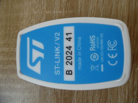

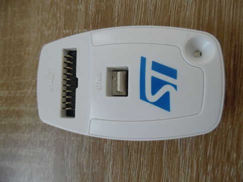

Please post a photo of the back of your ST-LINK/V2.
Regards
/Peter

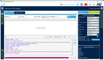

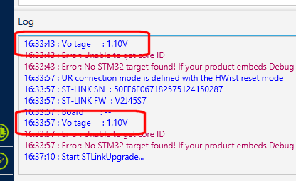

2025-05-12 7:51 AM
With a target voltage of 1.10 V, your board isn't going to be running.
You will need to power the board separately. The programmer typically does not provide power.

@Peter BENSCH here are some pictures
@TDK I'm on a laptop, with a fixed pc it should work? or do you need a powered usb hub? it's weird, I used to be able to program with this pc.
thanks

Your log shows that your target has insufficient supply voltage:
At that voltage, the target can't run - so it can't communicate with the debugger.

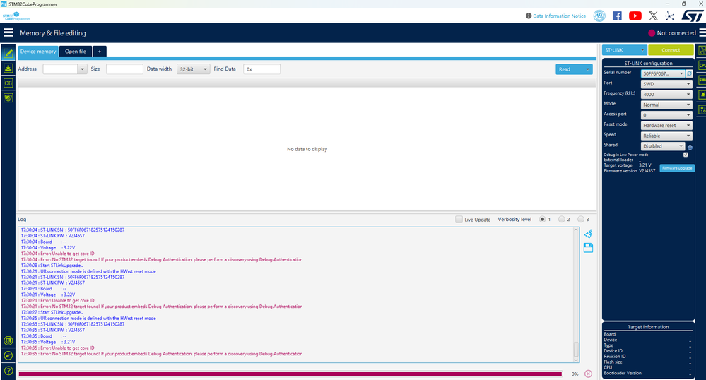

2025-05-12 8:33 AM - edited 2025-05-12 8:34 AM
I waited for the 230V sensor to start up, then the 5V communication card, and there it was, I now have 3.3V :
Thanks
