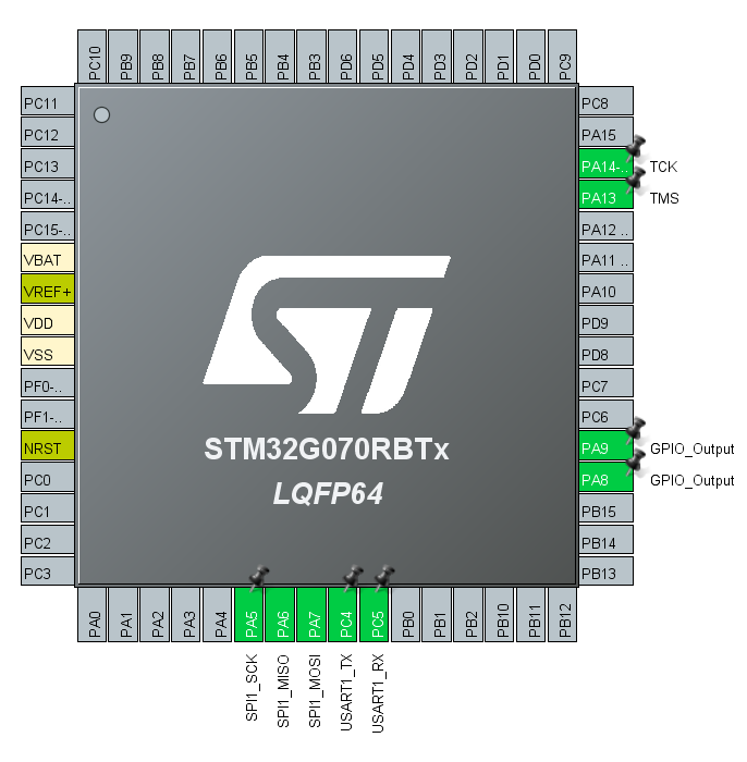

}SPI cubemx code:
static void MX_SPI1_Init(void)
/* USER CODE BEGIN SPI1_Init 0 */
/* USER CODE END SPI1_Init 0 */
/* USER CODE BEGIN SPI1_Init 1 */
/* USER CODE END SPI1_Init 1 */
/* SPI1 parameter configuration*/
hspi1.Instance = SPI1;
hspi1.Init.Mode = SPI_MODE_MASTER;
hspi1.Init.Direction = SPI_DIRECTION_2LINES;
hspi1.Init.DataSize = SPI_DATASIZE_8BIT;
hspi1.Init.CLKPolarity = SPI_POLARITY_LOW;
hspi1.Init.CLKPhase = SPI_PHASE_1EDGE;
hspi1.Init.NSS = SPI_NSS_SOFT;
hspi1.Init.BaudRatePrescaler = SPI_BAUDRATEPRESCALER_16;
hspi1.Init.FirstBit = SPI_FIRSTBIT_MSB;
hspi1.Init.TIMode = SPI_TIMODE_DISABLE;
hspi1.Init.CRCCalculation = SPI_CRCCALCULATION_DISABLE;
hspi1.Init.CRCPolynomial = 7;
hspi1.Init.CRCLength = SPI_CRC_LENGTH_DATASIZE;
hspi1.Init.NSSPMode = SPI_NSS_PULSE_DISABLE;
if (HAL_SPI_Init(&hspi1) != HAL_OK)
Error_Handler();
/* USER CODE BEGIN SPI1_Init 2 */
/* USER CODE END SPI1_Init 2 */

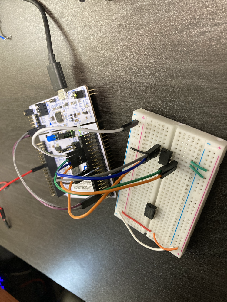

ConstantsI am using jumper wire on a bread board, but the results are always consistent, so I don't think it is a wiring problem?

Wait what?
I disconnected the 3.3V line and replugged it in from the nucleo board and got 0xEE instead of 0xDC
Thinking it is a wiring problem I tried shortening cables/replugging in cables.
Still getting 0xEE
I disconnect the 3.3V line from the Nucleo board and now I am getting the right info...? Where is the Winbond chip getting power from?
The 3 bytes returned are:
0xEF
0x40
0x18
This is consistent, what's going on? There is no 3.3V from the board connected to the Winbond, and these results are the same. If I disconnect the chip I get 0xFF for all 3 values as expected.
PA8 is D7 on the Nucleo (This is chip select)
PA9 is D8 on the Nucleo (This is write enable)
MISO, MOSI, etc are where you would expect.
The 3.3V is disconnected

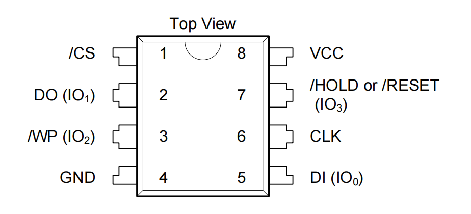

The device does have an async reset, might want to check pin 7

I think there is an electrical problem going. I am reading 2.7V on VCC (pin 8) without the 3.3V line connected from the Nucleo board. However if I use the 4KB chip, I only get .5V on VCC which is what I would expect (or 0 ideally).
I am not sure why there is voltage there. I have to basically disconnect almost every wire for it to read 0V.
With VCC disconnected, the Winbond chip seems to be giving me the correct values.
