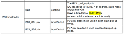

Have STM32G030K6T6 system that in bootloader mode fails to respond to I2C.
Am asserting BOOT0 pin 25, negating NRST pin 6, wait 500ms, asserting NRST pin 6, wait three seconds, then attempt to send MCU erase packet to I2C1 device address 0x57 but get NACK.
DSLogic Analyzer shows good I2C write to 0x57 but NACK in response.
Is there any signal from MCU that indicates the MCU is ready for bootloader download?
The 7-bit slave address on I2C1 STM32G03xxx bootloader is 0x58 0x56. With the write bit appended, it would be to 0xAD.
2023-08-31 10:14 AM - edited 2023-08-31 10:35 AM
2023-08-31 10:19 AM
What platform are you using to talk to it ? NACK is indicative that it doesn't recognize the address, or just not present. Start with a Write. Using PB6/PB7 or PB10/PB11 ?
The high order address is 0xAC or low order 0x56? Slave 7-bit address: 0b1010110x

2023-08-31 10:50 AM
That's what I get for copy+paste code that works for an STM32H7B3I.
Many thanks!
