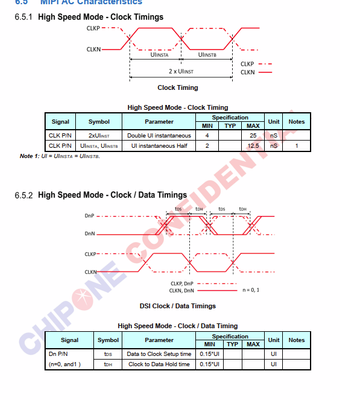

I want to use a C05300 based display with DSI.
I can write and read in LP mode, but not in HS mode. I guess it's a timing problem.
As seen from datasheet,
UI should be more than 2ns, so I use a 500MHz bit clock.
I use 24 bit data format to send data over DSI, so Pixel Clk = 480 x 2 / 24 = 40 MHz.
I there something I miss?

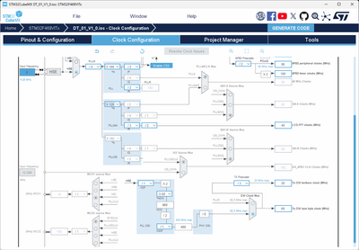

2025-09-08 11:09 PM
Hello @CDecouen
I recommend you have a look at this AN4860 Application note related to DSI Host on STM32 MCUs, providing guidelines and practical examples on how to configure the DSI Host depending on the operating mode.
Check the DSI PHY timings and DSI config on HS mode are compliant with the specification provided in the AN4860.
Can you try the DSI example in STM32CubeF4 firmware and update it according to your need. For example on : STM32CubeF4/Projects/STM32469I_EVAL/Examples/LCD_DSI at master · STMicroelectronics/STM32CubeF4 · GitHub

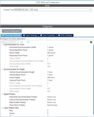

Hi @CDecouen , I am also looking to use CO5300 display for my project.
Can you please provide information about
LCD_VFP, LCD_HFP, LCD_VSA, LCD_VBP, LCD_HSA, LCD_HBP ?

Thanks @CDecouen
here is my init code for the display with 180 degree rotation. its seems to working but not as accpected
