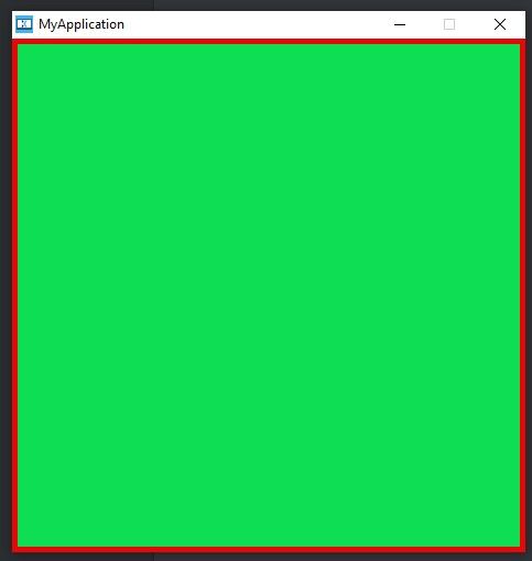

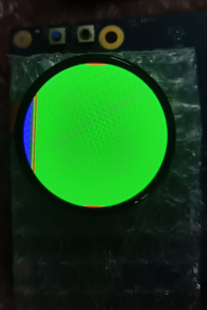

I am attaching images here; the first image is the simulator, and the second is the actual display.
Simulator Image:
Actual Hardware:

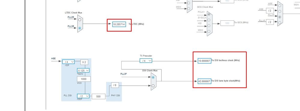

My configuration for clocks are as given below

I have been debugging for over five days, yet the problem still exists. I am new to touchGFX so i dont have expertise like you guys.

I solved the issue by changing my LTDC clock to 21.33 MHz and DSI clock to 42.666 Mhz.
A suggestion from @MM..1 really helped me to get the display working.

I’ve dealt with that before. A shifted image in DSI video mode usually points to timing or sync issues. Double buffering can help, but you might need to tweak the display driver settings or check the panel timing configs.
