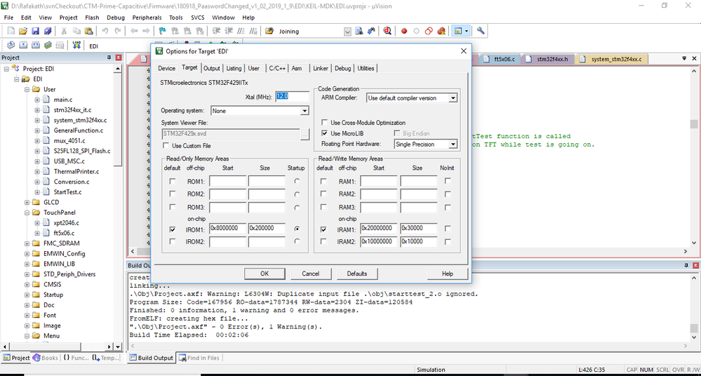

STM32F429IG is able to burn code with 1.7 MB program size indicated by Keil for STM32f429IIT6.
How it is possible, or I have wrong interpretation.
For more clarity it attached controller snapshot and keil compilation snapshot.
2019-06-01 5:24 AM
The parts share a common die, this has 2MB of FLASH on it, lower cost parts have less of it tested as the time on the test equipment is minimized (units/hour improves)
