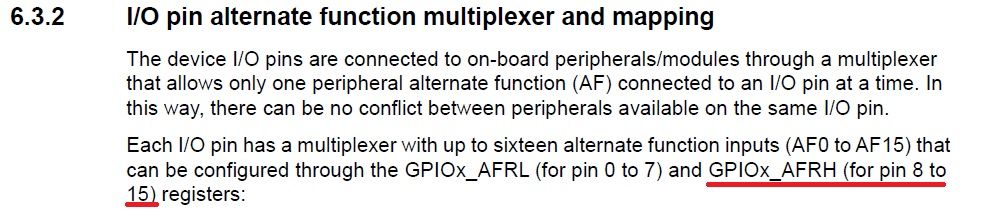

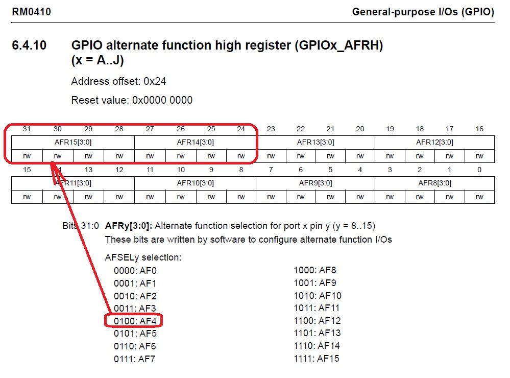

2019-05-23 11:37 PM
Looks like hours of fun..
I don't think PB14/PB15 are going to be covered by AFR[0]
AFR[1] &= 0x00FFFFFF;
AFR[1] |= 0x44000000;
I would suggest first get the USART outputting from the HSI clock source, then move the the PLL

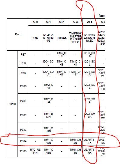

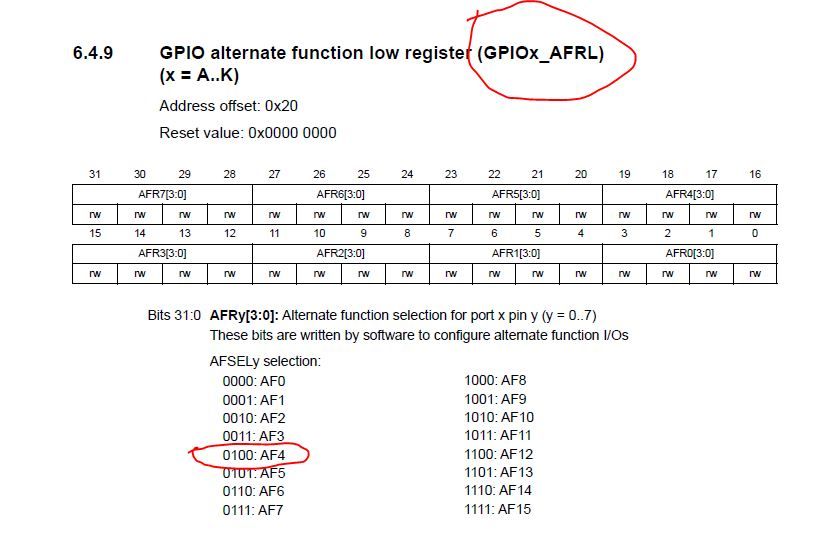

Thanks for your suggestion.
the manual says for UARTTx, Alternate function is 4 , AF4, Since AF4 is in AFR[0] ,( I think so, Sorry if I am wrong)
I tried with HSI also but there is no proper output
