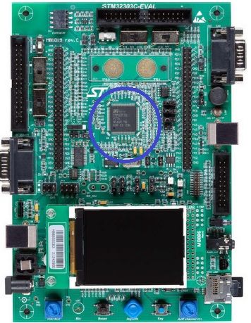

Which features are missing from the Discovery boards?
Observe the features outside the blue circle that your extra 200 Dollars/Pounds gets youYeah, ITM's SWV can be a pig, I've had it working on a couple of boards/pods, not sure ST-LINK is on that list. For the Discovery boards I usually wire a header so I can plug in a serial port adapter.
