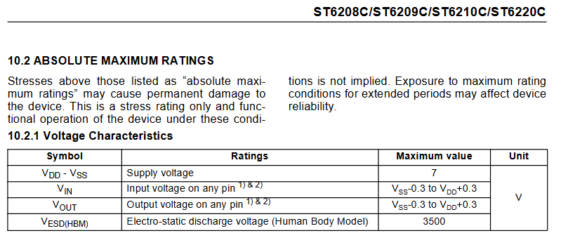

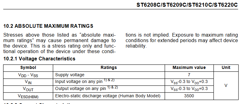

None of this helps use to understand the circuits in which you are using these chips.
That's what we need to see.
From those datasheets you can see that there's no way you'll get more than VDD out of any microcontroller pin.
So either your measurements are wrong, or you're going to blow the chips up!

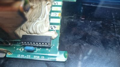

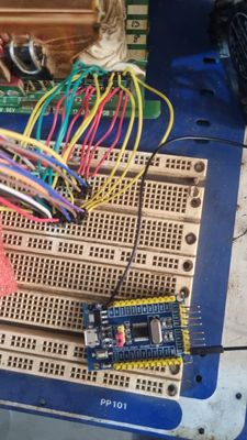

this just a pic i didn't connect my stm32 with charger
These measurements indicate similar but slightly different voltage levels between the original ST62-based charger and the STM32 replacement system.

None of this makes any sense at all !

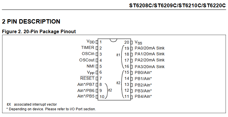

@boulganamed wrote:When I take a properly functioning charger equipped with the ST62 IC and measure the voltages on its pins, I obtain values such as: Pin 8 (VSS) = 14V, and Pin 12 (VSS) = 2.03V.
Neither pin 8 nor pin 12 is VSS:
If you mean that you are measuring those pins with respect to VSS then, again, your are exceeding the Absolute Maximum ratings for those pins:
Your readings must be wrong!
@boulganamed wrote:I replace the ST62 with an STM32 microcontroller programmed accordingly, .
What do you mean, "programmed accordingly" ?
How/where have you obtained the code to program the STM32?
And, again, you can't just plug an STM32 into the same place that the ST62 came from.
The ST62 is a 5V chip; the STM32 is a 3V chip: it is not a drop-in replacement - you need to redesign the whole circuit for the STM32's lower operating voltage.
